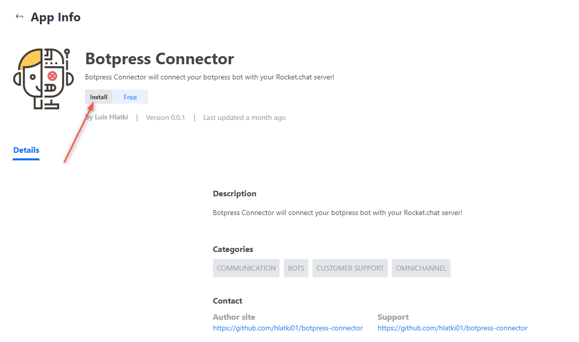

Install connector app
To be able to interact with the bot, you need a connector. Follow these steps to get it installed on your Rocket.Chat workspace.
  • Navigate to Administration > Workspace > Apps
  • Search and install the Botpress Connector app by Luis Hlatki

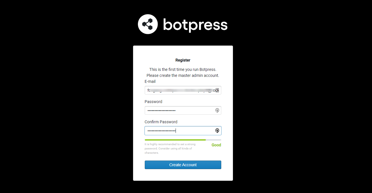

  • Spin up the container with
docker compose up -d
  • The botpress dashboard is made available at on port 3001 visit it and configure the admin user

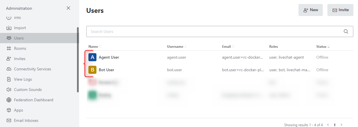

Create a bot and agent user
Create the following Rocket.Chat users to be used for the integration
  • Navigate to Administration > Workspace > Users
    • Create a bot user for the bot with these roles: bot, user, livechat-agent and livechat-manager
    • Create an agent user with these roles user and livechat-agent

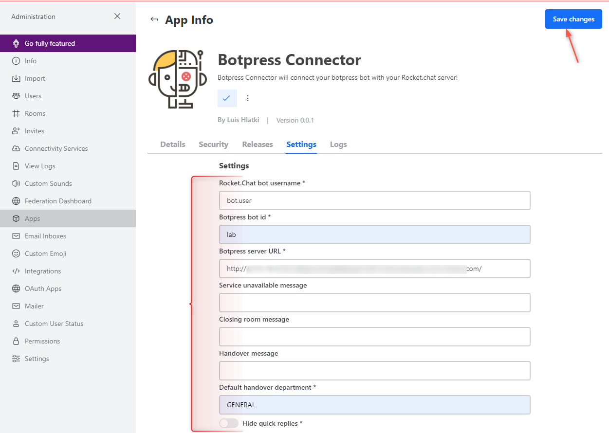

  • Configure the Botpress Connector installed earlier in Administration > Apps > Installed > Botpress Connector > Settings with the following details:
    • Rocket.Chat bot username: bot
    • Botpress bot id: lab
    • Botpress server URL: <http://your-botpress-server-url>
    • Default handover department: GENERAL
    • Then Save changes
